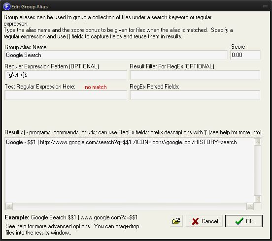

I keep thinking about this and how great it would be to have this functionality. This is probably the only feature i miss in FARR that i used extensively in other launchers. I know this has been discussed many times but I was thinking about a way to expand upon the current search history and came up with the following:
-make the history larger and persistent among restarts (perhaps create a new history.ini file with a different section for each history group)
-be able to specify different history groups in the results window of each alias similar to how the /ICON keyword works. See image below.
The nice thing about a system like this is that it would enable you to create different search histories for different aliases but also be able use a shared history for multiple aliases by using the same /HISTORY name in each alias.
-save the history string in a way that lets you know which alias launched it so that you can display the search term without the alias name and be able to search for history entries for a specific alias. Currently when you type ahistory it includes the alias name in the saved strings such as "igo donationcoder.com" where igo is the name of the alias.
-finally and most importantly, imo :D, would be to add an option in FARR's settings to "Include history entries in search results". So when using any alias that had a /HISTORY keyword you would include any relevant history results when using that alias using FARR's ranking system based on the search criteria. A nice option might be to use a standard FARR history icon which would allow users to quickly determine which are history results.

basically in the alias results section of your alias you would have the option of adding the key /HISTORY=<search group> at the end of the search string:
IMDB - $$1 | http://www.imdb.com/find?q=$$1 /ICON=icons\imdb.ico /HISTORY=movies
Fandango - $$1 | http://www.fandango.com/GlobalSearch.aspx?tab=Articles+Movies+People+Video&q=$$1&repos=Movies  /ICON=icons\fd.ico /HISTORY=movies
Google - $$1 | http://www.google.com/search?q=$$1 /ICON=icons\google.ico /HISTORY=search
Yahoo - $$1 | http://search.yahoo.com/search?fr=robo&ei=UTF-8&p=$$1 /ICON=icons\yahoo.ico /HISTORY=search
Amazon.com - $$1 | http://www.amazon.com/exec/obidos/search-handle-url?index=blended&field-keywords=$$1 /ICON=icons\amazon /HISTORY=hardware
Newegg.com - $$1 | http://www.newegg.com/Product/ProductList.aspx?Submit=ENE&DEPA=0&Description=$$1 /ICON=icons\newegg.ico /HISTORY=hardware
and farr would maintain a history.ini file that looked something like:

The nice thing about this is that you could add as many or as little search groups as you wanted and you could share search groups among aliases. Then in the future when you used your fandango alias to find showtimes and started typing dar,  "dark knight" would show up in the results list along with any other relevant past searches you made for the "movies" search group.
