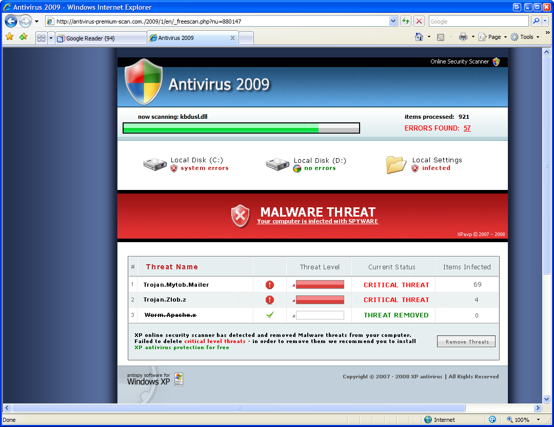

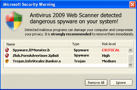

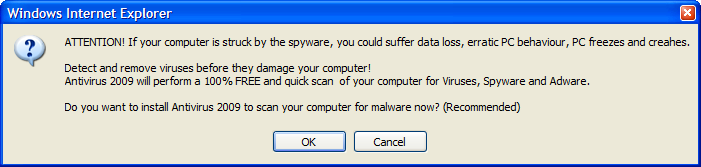

It had a popup window saying that malware could be bad for my computer and offered to do a virus scan on my PC.
It's definitely malware.

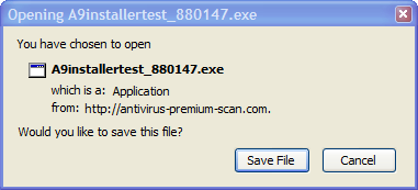

The above screnshot is shown so you can see the URL it sends me to. Once I closed the window, it automatically tried to get me to download a file:

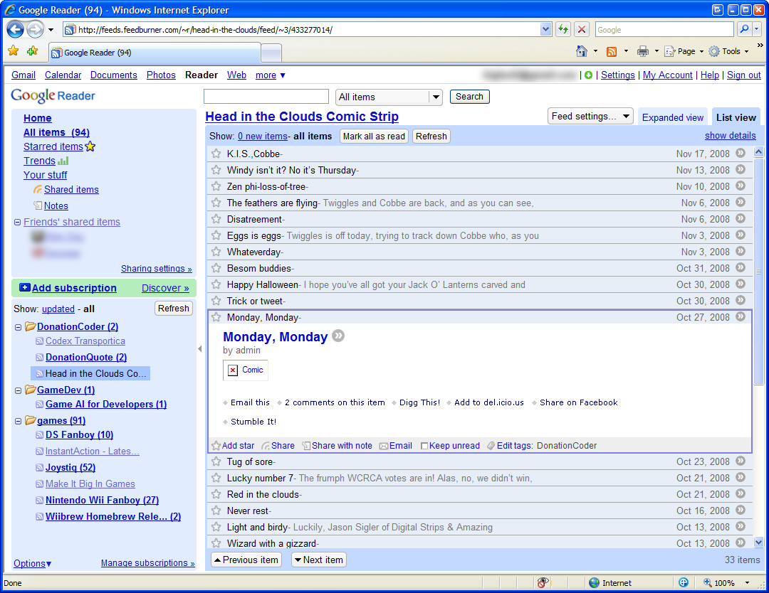

Also, I figured I should note that this is from Google Reader. None of the images are loading properly anymore and the URL the words "Monday, Monday" links to when I click is shown in the Address Bar.
It says Head in the Clouds in the URL, but it takes me to that malware site.

Deozaan: I just manually typed in the looong feedburner RSS URL from your google reader screenshot, and it works just fine here. Perhaps something is wrong with google reader, or somebody has done some DNS poisoning?
Re: new birdy comic website from nudone and timns
« Reply #39 on: November 19, 2008, 08:16 AM »
It must be Google Reader. I just typed it in too and it took me to the appropriate website. Anyone know what can be done to notify Google about this?
