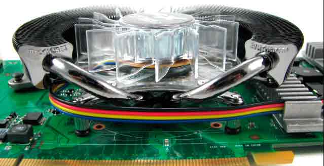

I'm a bit concerned about heat in a small (mid-tower) case, and anxious to control noise.  So, one of these cards seems a good compromise.
Neither is remarkably 'hot' in performance terms but each has 'cool' running temperatures and so is relatively quiet, too.
BFG 8800GT OCX or
BFG 9600GT OCX
Some data here

FORGET anything about 8800 cards and passive cooling. 9x00 cards are supposedly a lot better while stilling having close-to-8800 performance, but I have no personal experience with those. I'd recommend going a loooot lower-end, probably doing to 8300 or similar. But it's been a while since I looked at that market segment, so I dunno how low you need to go before passive cooling is feasible. 8800 definitely isn't' though. I'm not joking when I say I believe I could fry bacon on it.

The point about the two cards I quoted is that they are NOT passively cooled -- each has a fan in addition to a fair-sized heat sink.  It looks as though that combination runs the 9600GT OCX at around 60C while under sustained load.
fan/sink

Well, it's all in the review you linked before. The ThermoIntelligence coolers got good press in the various reviews I saw them being evaluated, not only for the low temps, but also for low noise, even under load. Hardware Canucks is a fairly trustable site (or used to be the last time I checked it out), so I guess both cards are adequate for your needs, unless you are really picky about noise. If that's the situation, I'll suggest you pay a visit to SPCR to find something you like, and have the absolute confidence that the card you'll choose will be silent (mmm, turns out some assemblers are still selling passively cooled GPUs).
If you're not that picky, it's a matter of choosing between cooler operation and lower performance (9600), or higher temperature, and some more oomph (8800). In any case, both are good choices, unless you are in the bleeding edge of gaming, where the 8800 could be a bit more future proof.
