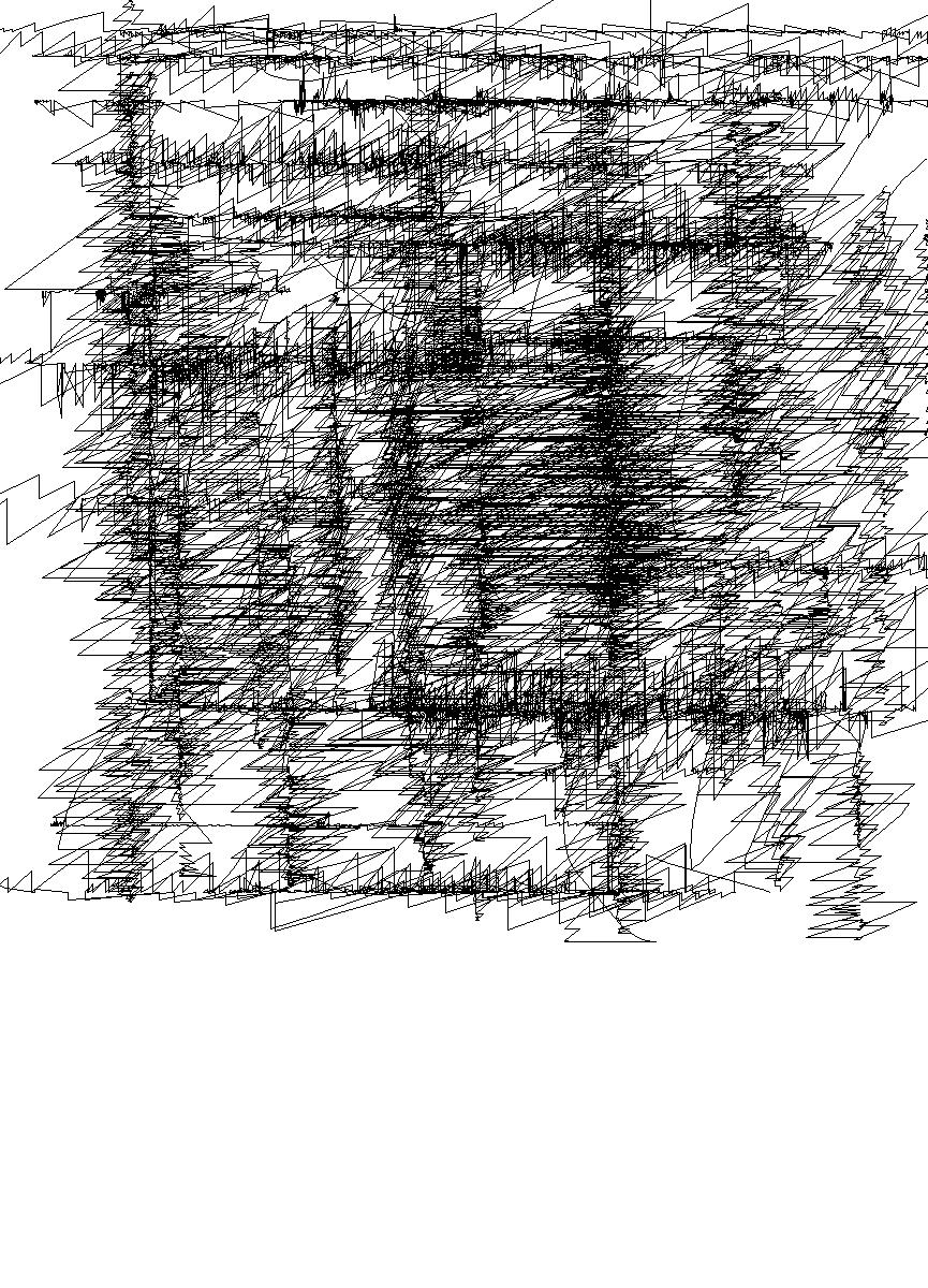

Sorry for the Thread Bump, (Yell at me if that's a NoNo!) I like to sometimes bring an old program back from the dead of thread death -
Now with a wink and a smile, DragLock ... doesn't, on my (XP) system, it's far from pristine to really keep the mouse stable.
So when you are faced with a new event, do something! So I used it as a quick art tool and made a modern art piece playing around for 30 seconds. What I get is that before DragLock notices the mouse has been moved, well, it moved. Then it yanks back. The result is that in paint, you get a triangle effect, but holistically along a line! So I used it as a new shading concept.
I'm sure my betters can do something more devastating with it, like help Brain take over the world, or help Pinky organize his fridge. ("Look Brain, all the tv dinners are in a row now!")

@TaoPhoenix, that's actually a really nice effect :D -
also looks good reduced (or enlarge the thumbnail onscreen), it gets nice and blurry then...
I've never actually used it for drawing (only for dragging :p) and true, it "doesn't" :)
