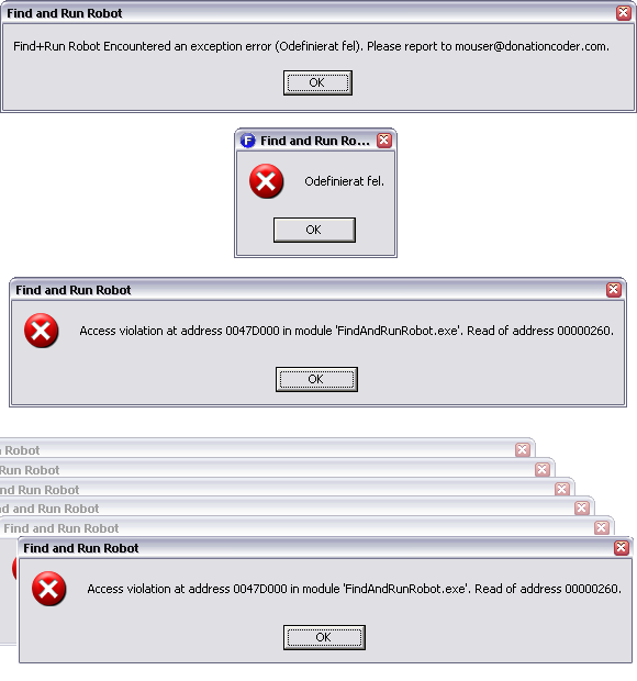

When viewing an internet page in FARR's html view mode and that page tries to close it's own window then FARR displays a "do you want to close window?" popup. So far so good. But clicking "yes" gives the error message below multiple times and then FARR freezes and a FARR restart is required.
To test it, save this as test.html, display in FARR and click close:

The v2.48.01 changelog said EmbeddedWebBrowser was updated which sounded relevant to this and so made me test this again, but the problem remains.
I should add that the error messages are not exactly like above. When I use FARR to access a flash based webpage that after a while tries to autoclose then FARR closes after this chain of error messages (in order from top to bottom):
I will look into it.
