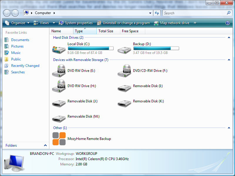

Alright, here is a question that may stomp even the most "clean" computer users...
How can I get more free space back, WITHOUT uninstalling programs, WITHOUT deleting things I need (VB projects, family photos, archived document stuff...), and WITHOUT removing my games (that's the point of freeing space, to be able to put another game (namely, Crysis) onto the computer).
I use my own SystemCare program, and that runs a small AHK script to clean my computer, followed by Disk Cleanup, CCleaner, and Steven Gould's CleanUp! - so junk files are not an issue. I run backups on my 2nd partition, so they are already out of the way. I uninstall every app that I don't need and keep only stuff I need, archiving stuff that I may need later onto the backup partition.
I can't get a second hard drive because cash is tight for the family, but I only have 9.16GB left, and it is draining fast.
My only idea is that I could move all my backups onto my old server (used for Sauerbraten by the DC Gamers Club), however then I don't know how to combine two NTFS partitions (my main Windows partition and the then-empty Backup partition). Either that, or there might be some software out there that searches for and deletes no-longer-needed things that Windows leaves (service pack uninstall files, etc). :-\
Ideas? :tellme:
-Brandon
(My backup partition is also running low on space, at just 3.47GB left - see the image below)
Re: How can I get hard drive space... without deleting (my) stuff?
« Reply #1 on: June 16, 2008, 10:20 PM »
That's impossible, dude.
« Reply #2 on: June 16, 2008, 10:21 PM »
Right, but isn't there SOMEthing out there that can remove old stuff from Windows updates and whatnot? Or can it be done manually?
« Reply #9 on: June 16, 2008, 11:14 PM »
I recommend using SpaceMonger!
If you're on vista, you potentially have a huge "hibernation.sys" or something like that file that you don't need (provided you don't need hibernation).
AND, id you ever had a blue screen, you may have a huge memory dump somewhere too (i wonder who had the great idea of dumping memory to disk after a crash? at least, make an option for it and don't enable it by default!!).

« Reply #11 on: June 16, 2008, 11:20 PM »
After about 2 minutes, it stopped scanning my game directory and got to the program files...
AH HA! Found some stuff! I can delete!

« Reply #13 on: June 16, 2008, 11:36 PM »
13.7GB, but still not enough - thats 2 games, tops.
Any software (in-Windows, if at all possible?) that lets me combine 2 NTFS partitions?
« Reply #17 on: June 17, 2008, 12:25 AM »
Alright, now I am confused...
Would it be better to just "combine" the two, or wipe and delete the 2nd and extend the first to take the space? Everything is backed up, and I wouldn't *MIND* a reformat, but I would prefer to keep everything intact.

« Reply #18 on: June 17, 2008, 12:37 AM »
can you clarify for us just exactly what it is you're trying to do (cos I'm unsure)
It's probably more practical to delete the second (empty) partition and extend your primary instead of trying to 'combine' the 2
however there's nothing to stop you from installing new apps to the second partition (I install all my games to a second drive which is equivalent to using another partition...)
The only fly here is if there is insufficient space on your primary for any files that must be installed to your primary (C?) drive

« Reply #19 on: June 17, 2008, 12:39 AM »
I need to get rid of the D:\ drive altogether.
I can grab a Vista DVD (I have several) and delete the D:\ parition, but my question is... how do I make C:\ use the new "unallocated" space?
« Reply #20 on: June 17, 2008, 12:42 AM »
you'll need a partition management tool - try GParted (a linux based boot CD) or one of the variants
« Reply #21 on: June 17, 2008, 01:15 AM »
There is another option...Windows 2000 already had an option to use dynamic disks. This concept is quickly explained: Imagine a harddisk divide up into two partitions. When both partitions are dynamic and one of them hits the predefined limit, both partition sizes will be adjusted accordingly without you intervening.
So if you remove the D:\ partition and change the C:\ into a dynamic drive...it will expand until the physical limit from the harddisk is reached.
Be warned though, once a partition has been converted to a dynamic one, there is no going back!
Look here for more info on the subject: http://msdn.microsoft.com/en-us/library/aa363785.aspx
This mode was intended for use in enterprise environments, so you will need a pro version (2000/XP) or better. Since I don't even care what the differences between all the Vista's are...you will likely need an equivalent Vista.
