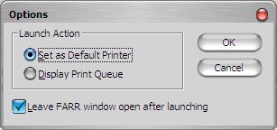

Plist working OK here - I must have out-of-date copies (FARR 2.00.145).  Is plist's purpose to set the default printer?  Could there also be an option to also open a particular printer, so you can see the progress of that printer's jobs?  I don't think you can do that from most launchers because the desktop links for printers aren't files?  Thanks...
It can already be done through the plugin options, but yea right-clicking or a modifier key would be nicer  :up:
