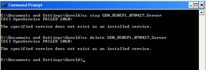

Unfortunately the sc command I tried already, it's error says:
"The specified service does not exist as an installed service."
I should have told that my system runs on Windows XP Professional (SP1).
Removing them manually with regedit does not work either.  :(

« Reply #4 on: May 25, 2008, 03:49 AM »
Sorry Carol, that doesn't do the trick either. However, it now showed a reference code so I'll guess Googling will do me some good.
