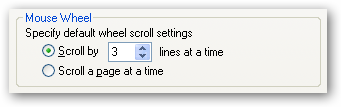

do you have any mouse-enhancer tools running in the background? if not check this setting in the control panel..
sri
  • Posts: 689
I had volumouse running. Closed it but still the same.
I do already have the mouse wheel settings as per your screenshot.
