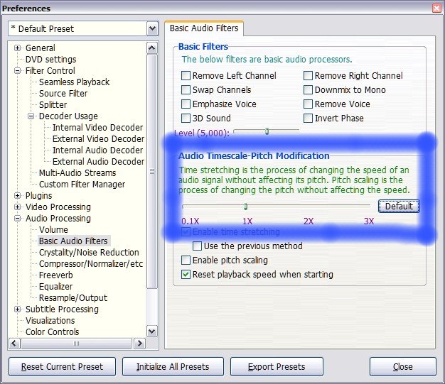

KMPlayer (shift++) gives me the chipmunk effect.
Try Winamp with the Pacemaker plugin as a last resort - it allows you to increase the tempo without affecting pitch, does it really well for audio files. I tried it with some videos and had mixed results mainly coz I use KMPlayer for video and Winamp does not care for my codecs. When the videos did play the pitch sounded normal.

i've just tried KMPlayer with a few .flv files to see if i got the chipmunk effect.
seems to work okay for me, i.e. no chipmunk effect when watching 2x and 3x playback.
if you are getthing the chipmunk effect it's probably because the "regular tone" setting isn't enabled in the playback options.
nosh
  • Posts: 1,441
Re: What video player plays audio clearly when video is sped up?

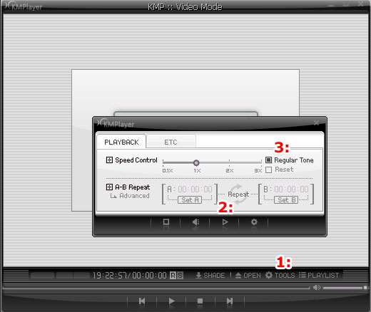

« Reply #10 on: May 21, 2008, 04:53 PM »
nudone's right. KMPlayer does allow this. I had 'time stretching' disabled, works well once you enable it.
nudone
  • Cody's Creator
  • Posts: 4,119
« Reply #11 on: May 21, 2008, 06:29 PM »
glad you found it, nosh.  :Thmbsup:
1: you can also access the control by clicking on the "tools" button on the main display (if you've got the default skin loaded).
2: then click the "playback" triangle button on the small control panel that appears.
3: you'll then have access to the "speed control" settings and the "regular tone" toggle.
