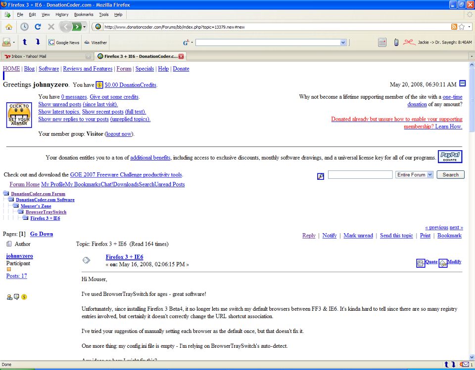

Just a quick update: I installed the new FF3 RC1 yesterday, which includes a new option during install to make FF your default browser. Just so you know, this does not fix the issue I've described - I was hoping it might. Oh well...
best,
JohnB
ps: unrelated topic - Firefox3 RC1 does NOT render the DonationCoder Forum pages correctly - screenshot attached. I assume the same is true with any SMF-based forums.
Re: Firefox 3 + IE6
« Reply #8 on: May 20, 2008, 01:17 PM »
Thanks for the info johnny, i'm going to try to address the browsertrayswitch soon i just have to handle a few other more pressing matters first.
As for the FF3, that's not good.. looks like css stylesheet is not being used properly.. i'll have to try to figure out why.

johnnyzero
  • Posts: 25
Re: Firefox 3 + IE6
« Reply #10 on: May 22, 2008, 12:06 AM »
Looks like you fixed the stylesheet - it now renders correctly in FF3.
