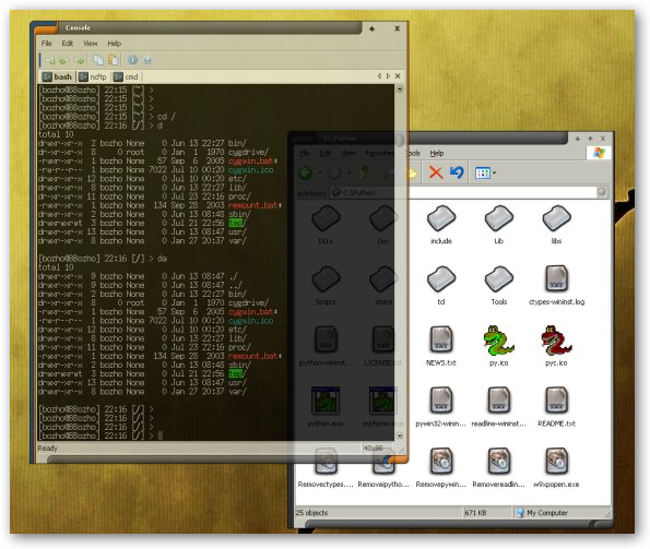

« Reply #9 on: June 01, 2007, 08:29 PM »
this is a very interesting program that i was about to post when a forum search returned this thread.. as it has already been mentioned, i'll just add a screenshot.. :)
