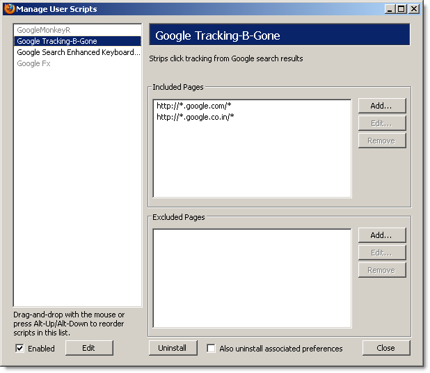

One can easily any other domains to the list of sites on which that (or any other) greasemonkey script should run.
For example since my search defaults to google.co.in, I have added it in the list like so:
To get to the above window, right click on the greasemonkey icon in status bar and select 'Manage user scripts'.
