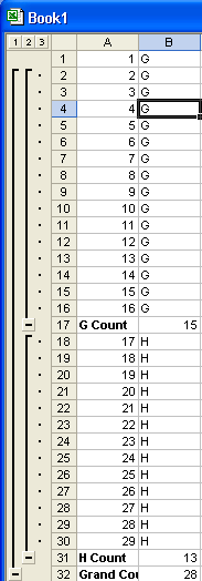

Hi see.
For such a case, an all Excel solution could be:
- Data > Sub-Totals
- VB Code to generate text files (scan rows and change file when count=500 or when cell contains 'Count'
Real generosity toward the future lies in giving all to the present -- Albert Camus -- www.InfoQube.biz
