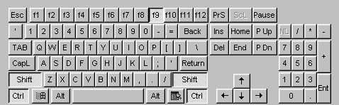

I don't care if I need to specify a "prevent these" or "allow these" list, for my situation it's a tedious list to configure either way.  Helpful would be a wizard that presented a model of a keyboard and one could click on the keys to be considered and added to the prevent (or allow) list:
