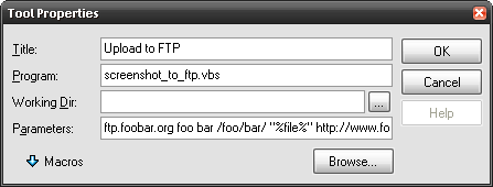

Usage with Screenshot Captor:
1. Copy the script into your Screenshot Captor directory
2. Create a new external tool link in Screenshot Captor:
  2.1. Menu "Tools" -> "Configure external tools" -> "add"
  2.2. Think of a nice title (eg. "Upload to FTP")
  2.3. Insert screenshot_to_ftp.vbs as Program
  2.4. Leave working dir blank (the script uses your windows home directory
        to create a small temp file which is deleted right after execution)
  2.5. The parameters for the script are:
      ftpserver username password externalpath filename [url]
      - FTP-Server: the server where you want to put your screenshot
      - User name: the user name to use for the ftp server
      - Password: the password to use for the ftp server
        (use "" for empty password)
      - External path: the directory on the server to put the file into
        Use a simple slash (/) if you want to upload to the root directory
      - File name: use "%file%" including quotes
      - URL (optional): the URL which is copied to your clipboard.
        Leave URL empty if you don't want to use the clipboard functionality
      Example:
      ftp.foobar.org foo bar /foo/bar/ "%file%" http://www.foobar.org/foo/bar/
      This will connect to ftp.foobar.org with "foo" as username and "bar" as
      password. It will then change to the directory /foo/bar/ on the server and
      put the selected file there via FTP. The given URL is then completed with
      the filename and will be written to the windows clipboard.
      PLEASE NOTE that both external path and URL have to end with a slash (/).
      If you want to put the file to the root directory of the server, use "/"
      (without quotes) as external path.
