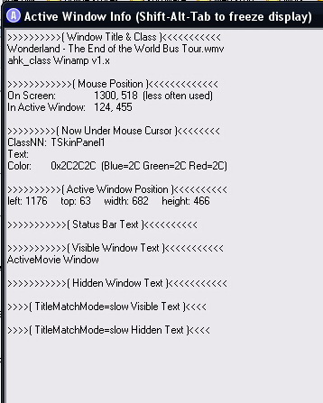

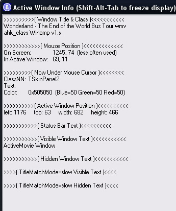

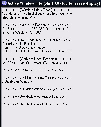

these are the results i have for kmplayers window. i've posted three screengrabs because i noticed the classNN changed depending on where i put the cursor over the window and i didn't know if the result was important.
