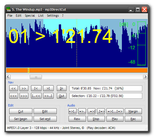

To avoid re-encoding you can use copy and paste in mp3DirectCut. You can open multiple instances of it at once. Very fast, the quality is maintained, of course. It's freeware.
