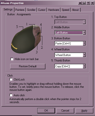

I have a dual mouse system (1 usb ergonomic mouse and a standard ps/2, both optical). I have noticed that if my ergonomic mouse should suddenly decide not to function correctly (doesn't happen that often), using the other for a few seconds usually gets the first one working properly again. I don't know why this is, but it's a another good reason to keep my system dual mouse.
It could also be possible that your mouse has some settings you may be unaware of that can cause the automatic clicking.
This is the mouse properties panel from my ergonomic mouse. The last option, if checked, might result in some of the same behavior you are reporting is going on with yours. Go check your mouse properties settings in control panel very, very carefully.
