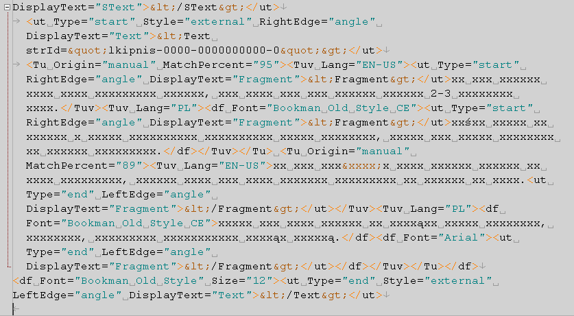

I'm looking for a utility that would read XML files and filter out or export only the contents of specified tags. I need to take this:
and get only the "xxxxxx xxx xxxxxxxx xxx" content as output. (I've had to obscure the actual text with x-es in the screenshot, since when I get material for translation, it's accompanied by the most frightful NDAs you've ever seen outside of the likes of NSA/CIA, and I'm not even kidding.)
It has to work in batch mode or be able to load and process any number of files at a time. (The actual numbers are in the thousands, so a manual open->run->save process will not do.)
Has anyone come across such a thing?
(I've written a Python script that does the job just fine for a number of specific tags, but it would be nice to have a generic GUI solution.)
Thanks,
.marek
