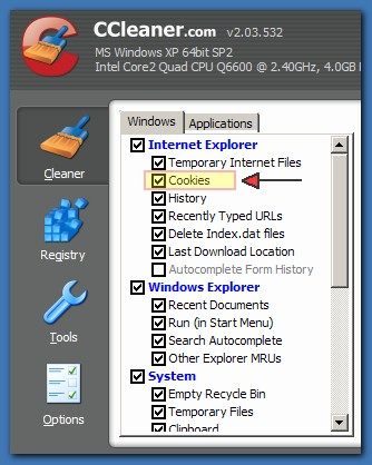

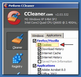

First, install CCleaner, and then open it up.  You'll see a page like this:
Make sure the options to clean cookies is checked both for Internet Explorer (on main page), and Firefox (on application page).

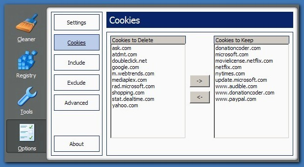

Then, click on the Options at bottom left, and press the Cookies button.  You should see a display like this:
If it's the first time you've configured it, you'll see a bunch of sites listed on the left, and none on the right.  Select the sites on the left which you trust or visit regularly and want to remember you.  Move them to the right hand side and they will be forever preserved.
For those you don't recognize, I'd say just go ahead and leave them to be deleted -- worst case scenario you'll have to log in to those sites again since they won't remember you until you do.  Remember that deleting a cookie is never going to remove your login info from a site, it'll just make it so the site won't recognize you until you log in.
The cookies you configure to "Keep" will forever more be left alone -- all those you leave in the left hand pane will be deleted whenever CCleaner runs its cleaning pass.
