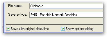

sorry to hear that, tomos.. it's always a good practice to check for this option before using any file renamers, image editors, mp3 tag editors and others of its ilk.. here's a sample from IrfanView which has this option in the Save dialog itself..

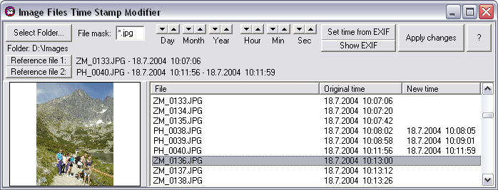

here are two more tools that will be useful in this task.
• http://www.sentex.net/~mwandel/jhead/
• http://jpgtime.learsy.com/
Re: Rotating JPEGs *without* changing modified date
« Reply #8 on: January 19, 2008, 06:43 PM »
thanks lanux :up:
EDIT/ doesnt seem to be possible in ExifPro
« Last Edit: January 19, 2008, 06:46 PM by tomos »
« Reply #9 on: January 19, 2008, 06:49 PM »
you're welcome, tomos.. just wondering which one did you use? :)
« Reply #10 on: January 19, 2008, 07:08 PM »
that Learsy one is a thing of beauty :Thmbsup:
# no install
# simple to use -
  • select files (all if you want) / click Set time from EXIF - it show the Exif time in the "New Time" column
  • compare
  • select those you want to change
  • click Apply changes
then go off and donate to the author (donationware :up:)
http://www.muralpix.com/donation.html
« Last Edit: January 19, 2008, 07:10 PM by tomos »
