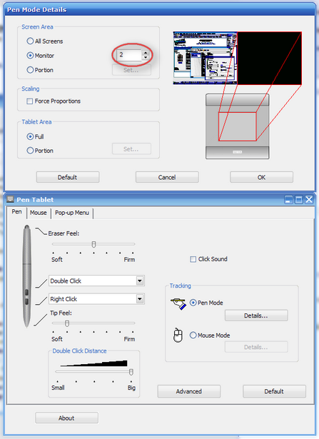

I found an AHK script HERE which toggles the active screen when using a Wacom tablet in a dual screen setup.
I am new to AHK but the script looks very basic, and I would like to improve and extend it to better serve my needs. In the first instance I am trying to replace the MouseClick commands with ControlClick which seems to respond quicker(?)
One of the controls that I need to 'click' is an updown toggle.
I have tried the following...
Code
ControlClick, msctls_updown321
and...
Code
ControlSend, msctls_updown321, Up
but neither work (change the value in the edit box).
What am I doing wrong?
Thanks for any help / advice, Ampa.

I think that controlsend is sending "up" literally (an 'u' and a 'p'). Replace it with {up}, to send the arrow up and it should solve the problem.

Ah-ha! Yes that little tip pointed me in the right direction...
Ended up targeting the editbox rather than the spinner and sending {Up} (seems to be case sensitive).
Code
ControlSend, Edit1, {Up}
Thanks for your help.
