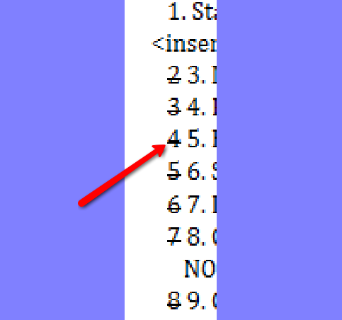

Edit - Hmmm. anyone know why the "4" won't allow the strikethrough?  :huh:
It's in there. It's just difficult to see because it bumps up against the horizontal line of the 4.

Ah!  I never would have found that!
