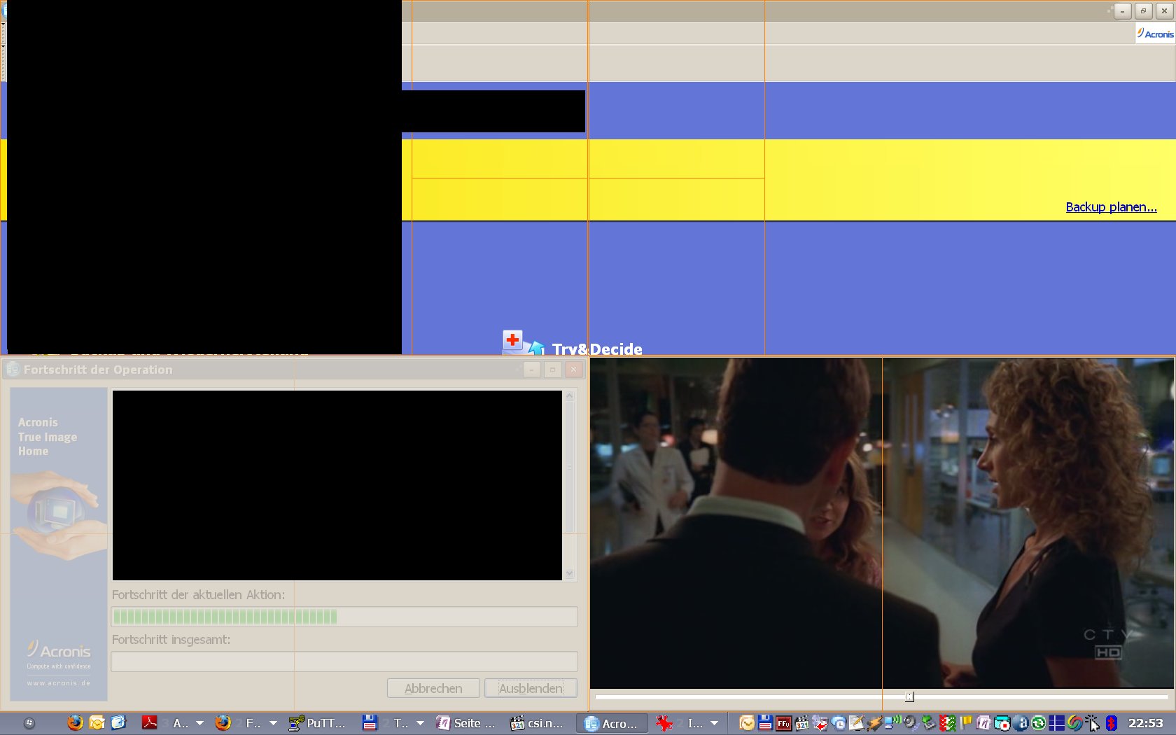

  • with save mode on I can't resize some popups although they are resizable
    (indicated by the resize handle - see attachment (can't you check for that resize
    handle since it indicates (standard behaviour) a window being intended for resize)

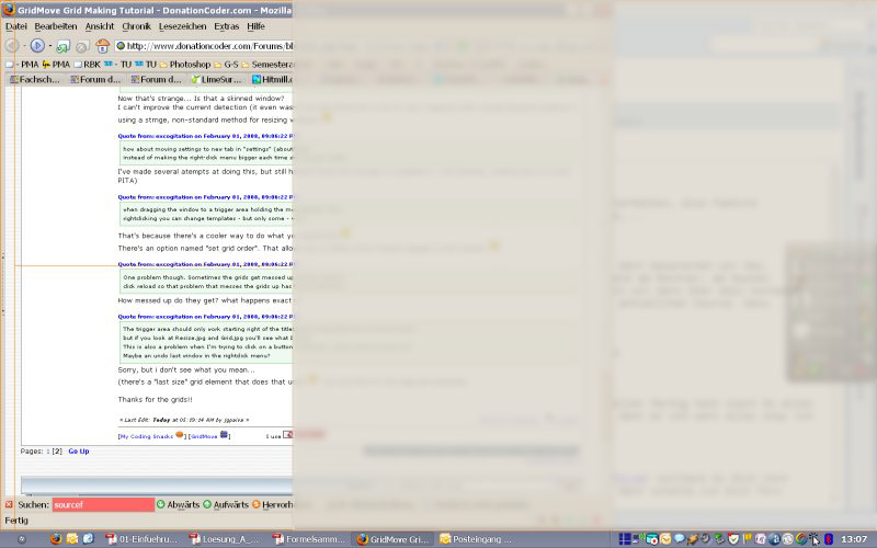

    One problem though. Sometimes the grids get messed up and you have to
    click reload so that problem that messes the grids up has to be solved first.
Now that's strange... Is that a skinned window?
I can't improve the current detection (it even wasn't me who found how to do it!), but i suppose that's caused because someone is using a strnge, non-standard method for resizing windows :(
How messed up do they get? what happens exactly?
See attached pics.
The trigger area should only work starting right of the titlebaricon ending left of the minimize button,
but if you look at Resize.jpg and Grid.jpg you'll see what I mean
This is also a problem when I'm trying to click on a button in Miranda... always messes up the size
Maybe an undo last window in the rightclick menu?
Sorry, but i don't see what you mean...
(there's a "last size" grid element that does that undo ;). You can find it in the edge grid template).
If you look at the small pic "Resize.jpg" I'm just about to click the resize (enlarge?) button
(therefore "Vergrößern" as popupinfo) - and ind "Grid.jpg" you can see that that (because the
button is within the 100px) this activates the grid and the window is resized according to
the trigger area the window was in at the moment.

Now i understand the thing about the resize. What i really find strange is that there's code to prevent that. Probably it isn't working correctly!
