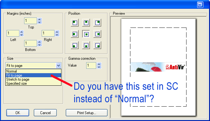

When I want to quickly print a capture directly from Screen Captor, the print size is fairly large.  E.g., when I capture a Properties dialog in Windows XP and print that directly from Screen Captor, the printed image is the size of the paper. In other words it seems to be set to "Fit to Page".  I cannot seem to locate anywhere at all within the settings to change this. How is this done?

Is there a way to quickly print a captured image with Screen Captor, and be able to change the printed image size?

you can set it to not stretch from the print preview dialog, which you will see ONLY if you use the File->Print command and not if you use the quick toolbar button.
i will put on my todo list the ability for sc to REMEMBER which stretch setting you had it at last, so that once you configure it once, it will remember for when you use the toolbar in the future.

I see Mouser has just replied, but here's an image anyway
