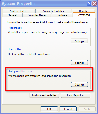

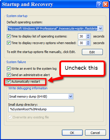

The issue is probably that the default behavior for Windows is to reboot on a BSOD. To change this behavior right-click on My Computer and choose properties. Go to the Startup and Recovery tab and uncheck Automatically Restart. This will allow you to be able to write down the details of the BSOD.
[attachthumb=#][attachthumb=#]

Thanks f0dder & Tinjaw (f0dder mentioned the auto restart tip in his post too :)) . It was probably a loose connection then - most likely to the gfx card. I thought of swapping the adapter ports coz Dxdiag (esp. directdraw test 2 - the block bouncing in 'normal' mode) was clearly more responsive for the non-DVI output, it started off a bit slow on the DVI port before picking up speed.
Though the PC didn't restart on its own during these freezes, I did have 'Automatically restart' enabled, it obviously makes sense to have that disabled. In my case the BSOD flickered for a split second before the display got garbled again - no restart though. I have been running with a paging file
