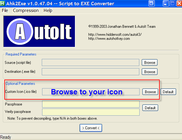

Re: help with icons
« Reply #4 on: November 29, 2007, 02:17 AM »
there isn't a change icon under properties. that is only for shortcuts, I want the original program's icon changed.
Use the compiler (convert.ahk to .exe) to browse to your preferred icon
Spoiler (click to show/hide)
nite_monkey
  • Posts: 753
Re: help with icons
« Reply #5 on: November 29, 2007, 02:21 AM »
Thank you Cranioscopical. I didn't know you could run the compiler. I have always just right clicked on the AHK script and clicked convert.

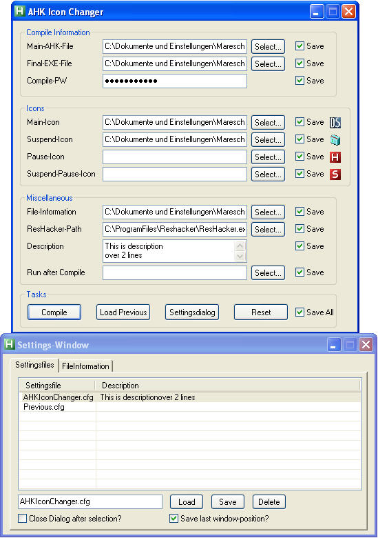

if you already have plenty of compiled AHK scripts then this tool will come in handy..
This script helps to change the icons of compiled and uncompiled (!) scripts.
It also allows to set the fileinformations (Copyright, Version, Description, ...) for a compiled script (has to be compiled with AHK Icon Changer).
• Icon (and Information)-Changer

That sounds like a useful tool. I will have to download that and use it once I learn AHK scripting more. :Thmbsup:
