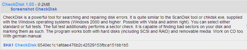

CheckDisk (scroll Down) - (Download)
tinjaw
  • Posts: 1,927
Re: Hard Drive Diagnostic Software
« Reply #11 on: November 27, 2007, 02:16 AM »
Thanks Phil. I will try it out and report back.

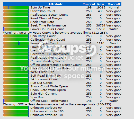

« Reply #13 on: November 27, 2007, 02:30 AM »
you can try speedfan too, click the "perform an in-depth online analysis...." button and see how many warning you get for smart data:
If you find a good solution and become attached to it, the solution may become your next problem.
~Robert Anthony

I don't have SpeedFan on the laptop, but I can check the SMART data via other means. I'll do that when I run the manufacturer's disk utility on it. SpeedFan is getting better and better all the time though. Good little utility.
