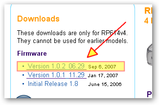

still unable to resolve the problem, i've decided to get a firmware update but i ran into another problem where the ftp server is inaccessible.. could some kind soul d/l the file and send it to me (PM me for my email). here is the link..
• http://kbserver.netgear.com/products/rp614v4.asp
