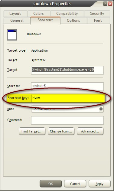

You could also create a shortcut on your desktop. E.g. Shutdown = shutdown -s -t 0 and Restart = shutdown -r -t 0
You could give it icons and/or assign hotkeys (right click ---> Properties)

Now create a shortcut to your MYSHUTDOWN.BAT folder (it can be in the C:\SHUTDOWN folder if you like) and in the shortcut properties choose the shortcut key you want to use to execute the shortcut.
The file is easily editable and you can use any shortcut you like.
