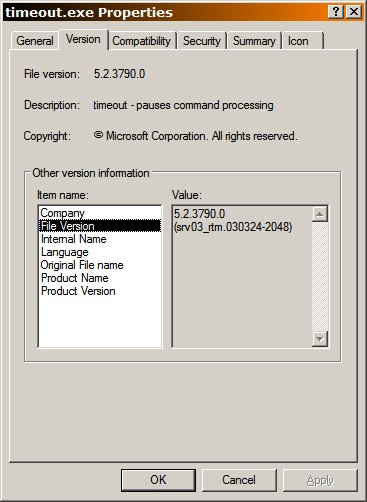

... TIMEOUT.EXE on your system, ... can be had as part of the Server 2003 Resource kit.
Were you referring to Timeit.exe , not timeout ??
- I don't see any timeout.exe at the page you linked to.

« Reply #14 on: November 09, 2007, 04:42 PM »
Indeed, it's not on that page.
But I swear that's where I got it in the past -- the Server 2003 Resource Kit.  I just checked my server's Windows folder and Timeout.exe is there.  Out of curiosity I checked it's version; definitely part of Server 2003.
Fun fact: The screenshot is 40K, about twice the size of the .exe itself.  :-)
