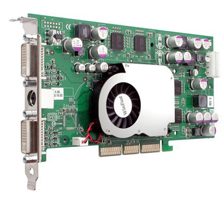

get a graphics card with dual dvi.. see accompanying pic (not an endorsement).. :)

Thanks Lanux, I upgraded to a GEForce 6200 [512 MB). It's identical to the Geforce 5200 as far as output jacks are concerned but the DVI output isn't lacking.
Right now my challenge is to make an older PC with an AGP 2x slot accept the now unused 5200 which is 4/8 x... don't suppose there's anyway to put off a mobo upgrade.
