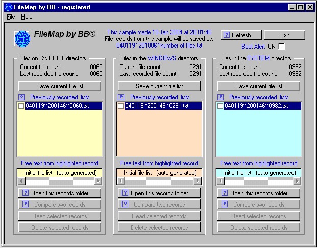

Check out FileMap. Also mentioned in this thread:
http://www.donationcoder.com/forum/index.php?topic=734.msg4425#msg4425
