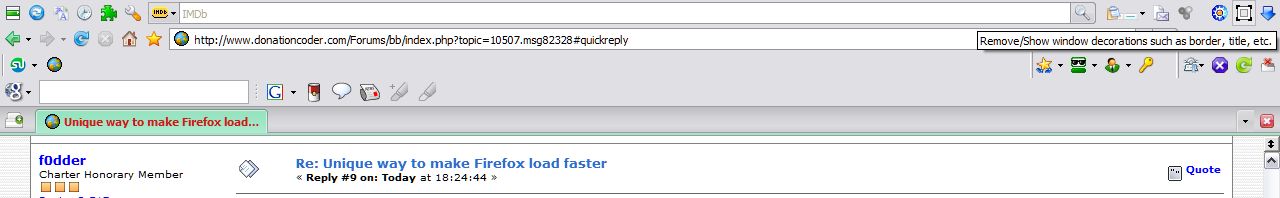

Neat on removing the close button, nosh. I'll bite. How did you do it?
A combination of MenuX which adds buttons with additional functionality ("incompatible" since the last several (2.x) versions of FF) & Menu Editor (lets you hide conventional menus) if memory serves correctly, coz I did this way back and haven't touched these extensions since. The screenie depicts the top of my display with FF active - the title bar and menus are hidden, not cropped out of the image.
