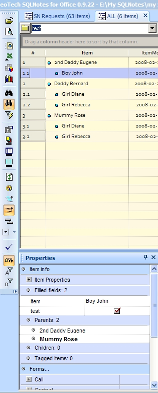

« Reply #702 on: February 21, 2008, 01:56 AM »
(I've decided to post here instead of the SQLNotes forum because I'm not receiving notices on a regular basis...)
I'm still struggling too with parents and children. I don't understand what I'm seeing.
1) Here are  my main settings.
- Item Saved --> OFF
- Context Parents -->OFF
- Hierarchy --> ON
No filter and 1 source (a yes/no field called "test").
2) I have 6 items (see the screenshot) :
1- Girl Rebecca
2- Girl Diane
3- Boy John
4- Mummy Rose
5- Daddy Bernard
6- 2nd Daddy Eugene
3) Ok, so here are the relationships in our family :
“Mummy Rose” is the parent of  all children :
- Girl Rebecca
- Girl Diane
- Boy John
“Daddy Bernard” is the parent of two children :
- Girl Rebecca
- Girl Diane
“2nd Daddy Eugene” is the parent of one child :
- Boy John
All the children have the same main parent : Mummy Rose.
4) According to my understanding the grid should look like that (when hierarchical view is enabled, with the settings described earlier):
--2nd Daddy Eugene
------ Boy John
--Daddy Bernard
------ Girl Rebecca
------ Girl Diane
--Mummy Rose
------ Girl Rebecca
------ Girl Diane
------ Boy John
But this is what I see (after refresh etc.) :

Re: SQLNotes...what is it exactly?
« Reply #703 on: February 21, 2008, 02:01 AM »
For this to work fine, the children must not have test checked. Either that or set hierarchy off
I can explain why later if you want.

« Reply #704 on: February 21, 2008, 02:24 AM »
Sure. Thanks Pierre. I removed the checks as you said, and yes, it works.
(But ... While I still don't understand why I should uncheck the "test" field for children, what I mostly don't understand is why -- when all the children also have the "test" field checked -- is the item "boy john" specifically not represented beneath its 2 parents... while the others are represented (and hence have "duplicates"). Anyhow, take your time!  :)).
Glenn Gould
« Last Edit: February 21, 2008, 02:26 AM by Armando »
« Reply #705 on: February 21, 2008, 02:33 AM »
Here is why,
The grid starts off with the data source, in this case it is all parents and children. There is only 1 boy john in the database.
In flat view, you'd get that list. Expanding each parent would show all children (grid creates new items for each children)
When you click hierarchy, the grid will arrange the source items under their parent. This works fine when there is 1 parent. It doesn't work when there is 2 parents and both are shown in the grid (since a grid item cannot be in 2 places). You can click "show all children" to display the ones which aren't shown.
There are times where this way is the best and other times where showing all is the best
In the previous version, I had it the other way. I'll need to add an option I guess  :-[
Real generosity toward the future lies in giving all to the present -- Albert Camus -- www.InfoQube.biz

  • Posts: 702
« Reply #707 on: February 21, 2008, 03:01 AM »
Here is an example where you do not want to see all subs:
You have a list of contacts arranged (sometimes) as Company with your company contacts as subs. This is great since SQLNotes will search the parent when dialing, hence you only need to enter the company number once.
so you have this, but under the company, you also have lots of other info (not related to contacts). If you show all subs, you'll get a list with not just your contacts, but all that other stuff (There is a workaround using filters but still).
It is also much much quicker to simply re-arrange items than generating the grid with all subs, so for large grids, this way is better. Both ways have advantages and disadvantages...
As to Girl Rebecca, I'm sure that Test was not checked for her to show twice
Show hierarchy, simply means, re-arrange the flat list to show parent-child relationship. Better off to leave it off in this case
« Last Edit: February 21, 2008, 03:04 AM by PPLandry »

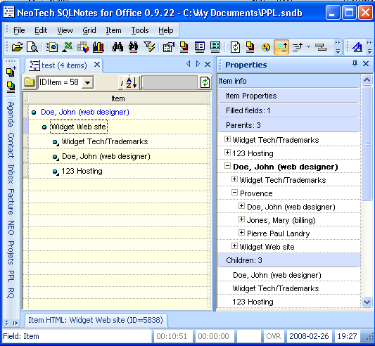

Just a heads up... Latest build is the first version to support Unicode content (in grid, properties pane and rich-text pane) (http://mantis.sqlnotes.net/view.php?id=78)
Also, grid hyperlinks is partially enabled (http://mantis.sqlnotes.net/view.php?id=62):
<a xxx>linkText</a>
where xxx can be:
1- an itemID
2- a Field/folder enclosed in [  ]
3- a Wikitag. Wikitags are enclosed in { } and entered in the WikiTag field
If the linked item is in the grid, focus is moved to it. Otherwise or if the link returns more than 1 item, the scratchpad grid is opened with the linked item(s).
