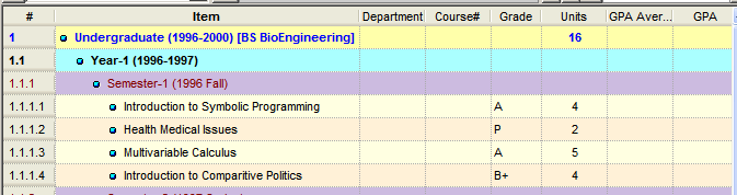

Re: SQLNotes...what is it exactly?
« Reply #360 on: January 09, 2008, 04:57 PM »
[By the way, Pierre, this is really great!  Can't say enough about the power of this program.]
CourseUnits hierarchy operations: Parent=sum(children)
My hierarchy operations are not working.  in the box, I'm only supposed to input "sum" right?  because the "((children))" automatically appears on the right when I choose "parent" from the drop-down.  Similarly, none of my equations for fields are calculating.  They are all blank in the grid, even after I close/reopen the grids.  How do I "activate" these calculations?
Also, for the last line of your code, I modified it to be:
Code
if isnull(Grade) or grade="" or grade="P" then CalcGPA=null
so it can ignore classes with P for passing.
Another point I wanted to make is about sorting, I think I've mentioned this before.  Sometimes, especially in cases like this transcript, things are ordered and sorted in a random way (ie not alphabetically or numerically).  If I accidentally click on one of the columns and it adjusts the sorting, I lose the sorting I had before.  How can I save a random sort to retrieve it later?
PPLandry
  • Posts: 702
« Reply #361 on: January 09, 2008, 05:08 PM »
A few points:
1- After entering an equation, click on Update if you want to apply it to existing items
2- There is a small bug in the hierarchy operations that it is only applied when data is changed. If you change any of the sub-item, the parent will recalculate. I'm fixing it right now and will update the daily build today.
3- re: sum: correct
4- sorting: right-click on the item and select sort ascending or descending. You can also manually drag-drop items. The column you right-click on is used to perform the sort. So to sort by CourseUnits, right-click that cell of the semester item. Doing it this way will save the sort order (make sure Grid>Sort criteria applies to sub-items is not checked).
I'll post a message here when the daily build has been updated.
Real generosity toward the future lies in giving all to the present -- Albert Camus -- www.InfoQube.biz

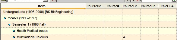

« Reply #366 on: January 09, 2008, 05:58 PM »
Have you entered a grade and a courseunit for the courses ?
Yes, I had those in before I added the equations and function.  Here's a screenshot:
« Last Edit: January 09, 2008, 05:59 PM by superboyac »
PPLandry
  • Posts: 702
« Reply #367 on: January 09, 2008, 06:01 PM »
There is a space between GPA and Average, did you enclose the field between [  ] ? Send me the file if you want, I'll take a look

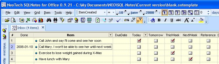

SQLNotes can easily produce you a Journal list of the information you entered. This is just another way to find stuff. You say, "I know I entered that info last week, but where did I put it...".
Simply activate the DateFilter toolbar and set the filter field to ItemCreated (or ItemModified), select the time span (1 day, 1 week, 1 month) and all items entered that day/week/month will be displayed. Other software journal feature will seem primitive compared to this!

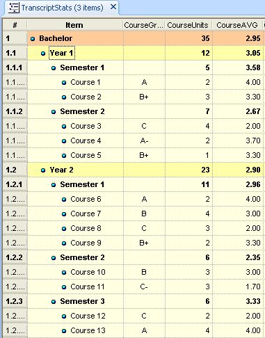

Well, the transcript grid is working properly now.  I used the method where I have a Pass/No Pass column because I wanted to keep track of how many units were Pass anyway.  So, now there is a template available for people who want to enter their transcripts into SQLNotes, which I think is useful.
I mean, do you guys see how powerful this program is?  It's like I'm creating my own mini-programs here.  I bet there is someone out there selling some kind of transcript software.
