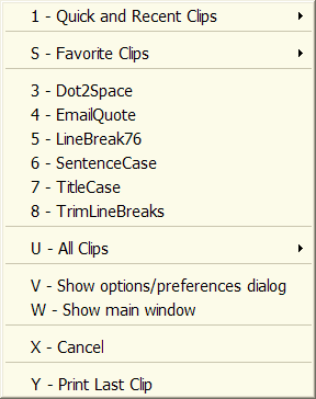

rjbull hit the nail on the head with CHS method, just in case you are interested:
  • CHS doesn't have a way to auto-apply formatting every time you copy something to clipboard per se, BUT you can do it all in one step!  Just select the text in question and then trigger the text formatting preset (rather than copy first) -- see more detailed instructions below.
  • But what it will do is let you create+configure a whole bunch of different custom search+replace/reformat/etc presets and show them on a quick pop-up menu for you to apply to text you have just captured while you paste it.
  • It comes with some of these text formatting presets that do things like convert the case of the text just copied.
How to use text-formatting preset in quickest way:
  • Select the text in question wherever it is
  • Bring up quick-popup menu in CHS (ctrl+alt+Q by default)
  • Choose the Text Formatting preset submenu (hit T)
  • Choose the text formatting preset to apply (you can create your own ones from the CHS main window)
  • Text will be copied, formatted, and pasted back
This "one-step" process is actually very useful in doing things like converting a line of text from one case to another, etc.

  • Posts: 3,217
Re: Autoreplace in clipboard
« Reply #14 on: October 10, 2007, 02:25 PM »
i should add some extra search and replace slots shouldn't i? i'll put it on my todo list.
Thanks!    :Thmbsup:
are you saying the external tools configuration is still not working for you,
The external tools configuration is working for me - once I picked the right tool  :mad:  Maybe I'm not good enough to get MTR (32-bit version of MiniTrue) to work here, or maybe its LFN handling is too restricted.
or you are wanting to do something else besides what the current system is designed to do?
In a way, yes.  I'd like to be able to add external tools to the Formatting Presets menu on the pop-up, which doesn't seem to be currently possible.
Are you aware of the following:
  • It seems impossible to delete a formatting preset.
  • CHS has two rather different uses of the word "Preset" - one in the sense used here, and another from the main menu, where it means the appearance of the main window.
