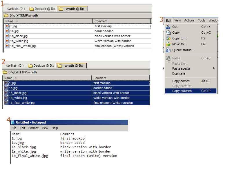

xplorer2 has a nice feature suited for this - Comments - check that page and read about 'em.
comments that I can easily printout with a file list or simply with associated file name
You can copy columns (including filename, size, date, comments, etc.) in x2 and paste them where you wish, like in this example:
ofcourse i added the proper tab amounts so they would line up nicely :) but i think this is what you are after.
Re: Versioning of files
« Reply #7 on: October 05, 2007, 10:36 AM »
mitzevo,
that is nice !
#  Set or change a comment with a single keystroke <Alt+Z>
# Set/clear comments for many files at once (add to existing comments)
& so easy to copy,  :-*
EDIT: Seems to be available in free version as well..
unfortunately :) I use DOpus[8], will have to check out their take on this
