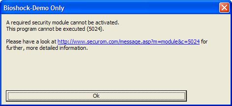

knowing full well that i won't have enough time to play BioShock, i downloaded the 1GB+ demo.. after installing, i had attached a hard drive from another PC for trouble-shooting and the next time i tried to launch the demo, there was the standard warning from SecureROM and since i'm disinclined to find out more about this "protection" & how to disable it, i'm just going to take a deep breath & uninstall the demo without even playing.. ah, the irony!
btw, the image came from this thread..

PLEASE give it a chance. BioShock is an *amazing* experience.  I usually don't get into FPS games anymore, but this one's incredible.  The atmosphere alone is worth playing on "easy" just for the tourist experience.
The SecurRom error popped up on my system too.  In my case it was due to the SysInternals Process Explorer I keep running mostly all the time.  SecurRom (BioShock anti-piracy crap) detects certain debugging & disassembly tools and won't run.  Process Explorer is one of them.
The deal is, PE leaves a driver behind in memory after it runs, even if you shut it down.  BioShock sees the driver and won't boot.  For the rest of the session.  *groan*
Solution(s):
1. Reboot Windows and don't start PE.  Bioshock loads just fine for me this way.
2. Upgrade PE to the latest version from SysInternals -- Mark R. has recompiled a new build that avoids SecurRom's paranoia.
If you're not using Process Explorer, then check what else is running in the background.  SecurRom is touchy about debugging tools.
HTH,
Ralf

yes, you're right.. if i had started PE then i have to reboot the PC, just closing the program won't do.. >:(
Quote from: http://www.securerom.com/message.asp?m=module&c=5024
SecuROM™ has determined that a Process Explorer program is running in the background.
    * Please close this program and reboot your machine before you start the application.

lanux128: Grab the latest PE from SysInternals and rock on.  SecurRom can't see the newest version, even when running in the background.

i've grabbed the latest PE which promises to hide itself from SecureROM but i reckon it'll be some time before i try out the demo as i blew another weekend playing Gothic 3.. :)
on another note, all the googling brought results to the latest patch that cracks SecureROM but no official work-around from SecureROM itself. i guess this highlights the angst it brings on to the gamers..
