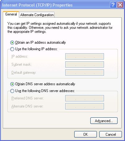

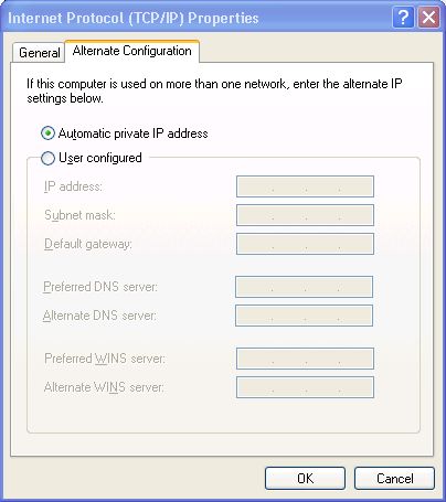

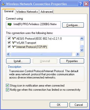

But how do you assign the PC a static IP address ?
I have looked in the control panel or just clicking the right clicking the wireless icon in the system tray helped me get to the properties tab and I scroll to the TCP/IP settings where it appears I can set a General and Alternate configuration.
See pics attached
However, since I'm using a laptop for this purpose, if I set a static ip address, and I decide to go sit at Starbucks in a public network, I may possibly find that I'm unable to access the network at all (never mind about the mini-webserver I was referring to earlier), unless somehow the laptop is smart enough to look in the Alternate configuration when I'm out in a public wireless network.
In other words, ideally after configuring, when I'm in my personal home network, it should be smart enough to pick say 192.168.1.99 and when out in the wild public network, my laptop should be smart enough to revert to Dynamic IPs since at that point in time, all I'm interested in is a internet connection ( I won't be worrying about connecting to the mini-webserver - of course it would be nice if I could connect to it - but I don't think I would be able to since I won't be able to set any port forwarding in any case)

Patteo: From what i understand, the miniserver isn't the laptop, right?
So, you can just assign a fixed ip to the miniserver, and leave your laptop on dynamic ip...
Another option would be to assign a static ip to the laptop on the alternate config, and leave the default config on auto. The problem with this approach is that sometimes it won't work as expected and you have to disconnect/connect a few times until it figures out it should be using the static ip.
I was under the same impression as jgpaiva - that the server was not on the laptop.  In your case, I think the above option is the way to go.  I have never had issues with multiple profiles on my laptops, but they are using the Intel 2200bg wireless card that is VERY GOOD compared to any other card I have seen.  They came with this card and the software (IntelPROSet Wireless) with it allows me to order the profiles.  If it finds the connection for the top profile it stops; if not, it goes to the next to try.  It prevents the issues mentioned.  If you can find a wireless package similar to the PROSet Wireless package and use it in place of Windows wireless services, I think you can avoid the unexpected issues jgpaiva mentioned.
