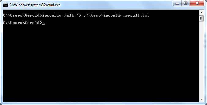

On any of your computers you should open the command line, just to see if that computer receives a proper IP nuimber. Use the Windows key + R to open the Run window. type inside this window 'cmd' and hit the Enter key. A new window should appear where you can type 'ipconfig /all >> c:\temp\ipconfig_result.txt'.

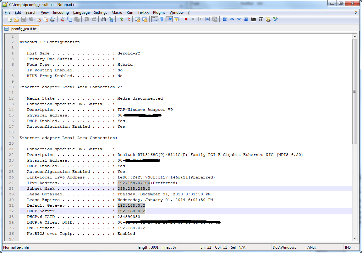

That line will generate a text file called 'ipconfig_result.txt' in folder 'C:\temp'. Inside this file you will see all available network connections on that computer and how these are configured.
The highlighted blocks show the most important IP addresses. You should notice that the network connection called 'Local Area Connection' has an IPv4 address that starts with 192.168.xxx.xxx. All the other highlighted IP addresses are similar, these also start  with 192.168.xxx.xxx.
If you check this on the PC that is hardwired to the router, you will see IP numbers that start with the same 192.168.xxx.xxx, it is also possible to that the IP numbers in your network start with 10.0.xxx.xxx. Do the same on any other PC and verify there if the IP numbers from the Wireless Network Connection on that PC start with the same 192.168.xxx.xxx or 10.0.xxx.xxx. When that is not the case, you have a bigger networking problem which requires the help from someone who has or still does maintain computer networks. It is at least a problem I cannot hope to solve from this end of the globe in a timely fashion.
