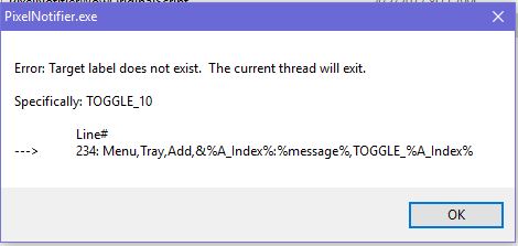

So I created an array of 47 pixel coordinates to monitor for specific color changes, there are 11 different possible colors, therefore 517 lines of monitor coding.
I'm using PixelNotifier from this site, by Skrommel. https://www.donationcoder.com/Software/Skrommel/index.html#PixelNotifier
The trouble is, it can't seem to handle more than 9/10 concurrent lines of code before erroring out.
This is the error I see, if there are more than 9 or 10 lines of code:
I would definitely like to expand this capability to be able to monitor more pixels, preferably to 517 (memory allowing) or at the very least, around 50.
I'm happy to donate to anyone who can fix this for me! I looked at the rules I could find on here, and I didn't *see* anything against offering to donate for code snacks, but I certainly think I ought to buy you a couple of cheezeburgers if you can help me with this. ^_^
If you need more info, I'm happy to give it, too!
Thank you for reading! =)

The error message shows what would need to be added to make it work for the 10th menu? entry.

what would happen (you have to try it yourself after installing AHK) if you simply add more labels
Code: Autohotkey [Select]
  1. ; start at 50
  2. TRIGGERED_50:
  3. triggered=50
  4. Goto,TRIGGERED
  5. ; all the way to 10
  6. ; ......
  7. TRIGGERED_12:
  8. triggered=12
  9. Goto,TRIGGERED
  10. TRIGGERED_11:
  11. triggered=11
  12. Goto,TRIGGERED
  13. TRIGGERED_10:
  14. triggered=10
  15. Goto,TRIGGERED
  16. TRIGGERED_9:
  17. triggered=9
  18. Goto,TRIGGERED
  19. TRIGGERED_8:
  20. triggered=8
  21. Goto,TRIGGERED
  22. TRIGGERED_7:
  23. triggered=7
  24. ; etc
and do the same where you find the "TOGGLE_9:" line just add TOGGLE_50 .... TOGGLE_10 above it.
