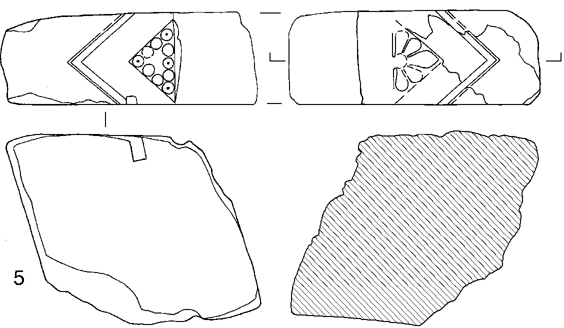

Orientation of Sections & End-views
(i) end-views
(i) end-views
Note:
images are converted from high-resolution 1 bit tiffs designed for publication – so lines wont look so great at this resolution

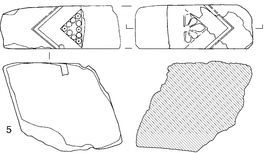

  1. where the section was horizontal ((ii) below), I kept the plan-view face to the top of the section.
    (ii)
    (ii)

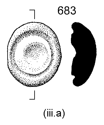

  2. where the section was vertical (iii), I did not stick to any option i.e. plan-view face was sometimes shown — in section — adjacent to the plan-view (iii.a), and sometimes shown to the opposite side of the section (iii.b). Using the “L” section markers gave the freedom to do this.
(iii.a)
(iii.a)

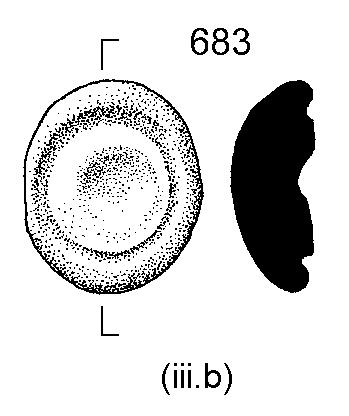

Convention would have us showing the plan-view face on the opposite (furthest) side of the section (iii.b) – this is the opposite of how an end-view would be shown.
(iii.b)
(iii.b)

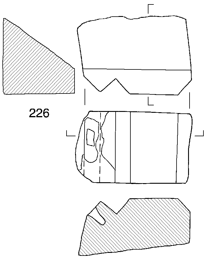

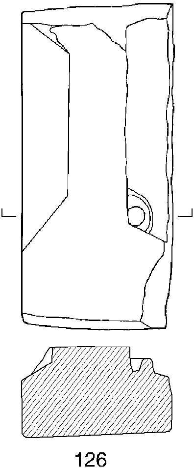

End-views are conventionally shown as if you were to simply rotate the object 90° and then draw the end view – see image (i) at top of post. This results in faces always being adjacent to each other. It was often clearer to show sections with the same orientation as end-views – see (iv) and (v) below.
(iv) section shown with same orientation as an end-view
(v) both sections shown with the same orientation as end-views
