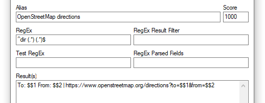

Try this
Alias name: OpenStreetMap direction
Alias regex: ^dir (.*) (.*)$
Alias result:
Code
To: $$1 From: $$2 | https://www.openstreetmap.org/directions?to=$$1&from=$$2
Things missing: A way to default the from location to ones current location. Selecting mode of transport (default is car). Such details should be findable on their wiki or help pages
https://help.openstreetmap.org/questions/73989/setting-the-initial-to-address-in-directions-by-passing-a-parameter-via-url
edit: sorry that gives an error, need to encode the & character. Will update later when more time. My mistake, it does work.

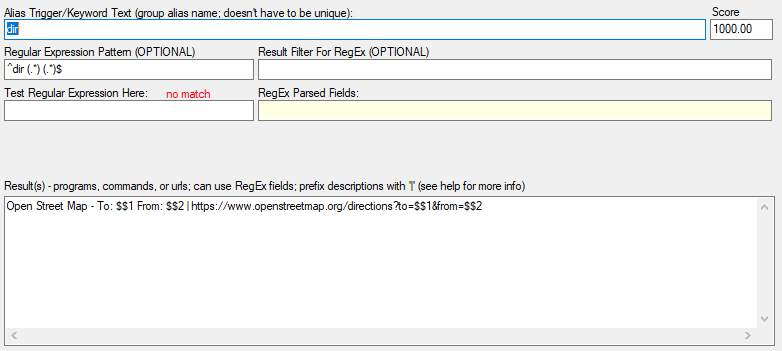

« Reply #4 on: October 11, 2020, 09:23 AM »
Thank you so much for this. See bold below for one unresolved issue.
Just for clarity:
1) Set up a new custom alias.
2) Call it "dir" [no quote marks].
3) Put in the Results box [without the quote marks]: "Open Street Map - To: $$1 From: $$2 | https://www.openstreetmap.org/directions?to=$$1&from=$$2".
3) Put in the Regular Expression Pattern box [no quotes]: "^dir (.*) (.*)$".
4) Form of search =: dir [destination] [from]
See the clip attached.
There is one issue: this formulation doesn't cope with places with more than one word as a name (like New York, for example). Is there a solution to that, do you think?

If you use plus characters "+" instead of spaces then it works as is. For example try searching
Code
dir yonkers+ny long+island+ny
That's because FARR will detect the two parts as whole strings and the website will treat + in the URL as spaces.

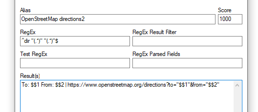

Alternatively you can tweak the regex pattern in FARR to require quotes around the to and from strings
alias regex:
Code
^dir "(.*)" "(.*)"$
alias results:
Code
To: $$1 From: $$2 | https://www.openstreetmap.org/directions?to="$$1"&from="$$2"
To use that you would type in the FARR searchbox
Code
dir "yonkers ny" "long island ny"
Note that you can keep both aliases, the one which requires quote marks and the one without, active at the same time. Because only one will trigger depending on if you type the quotemarks or not.
That would look something like this
and
« Last Edit: October 11, 2020, 12:05 PM by Nod5 »
