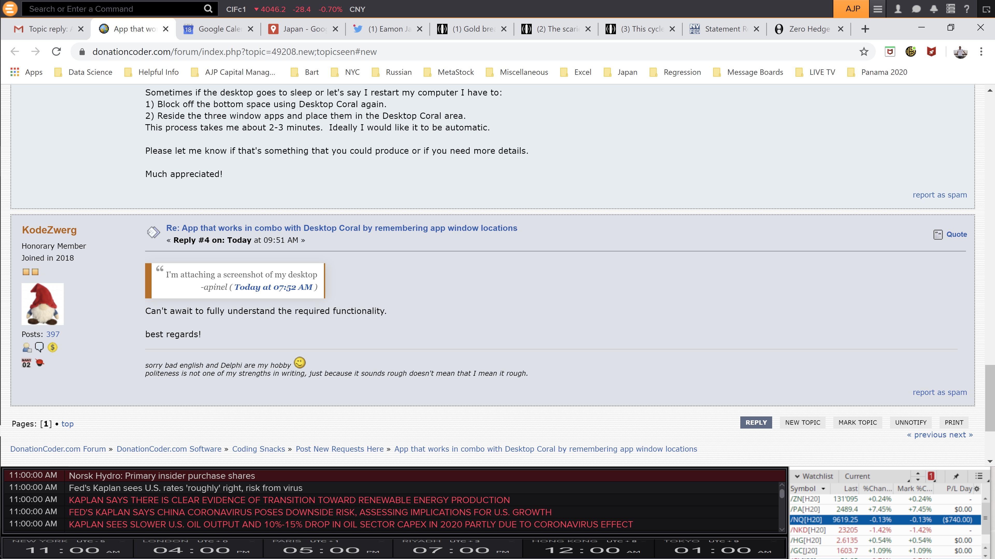

Hello KodeZwerg,
Thanks for volunteering.  I'm attaching a screenshot of my desktop, which will help explain what I need.  The bottom of the desktop shows three app windows:
1) A news headline window app (see the red fonts in all caps).
2) A clock window app (very bottom).
3) A trading watchlist app (on the right).
These three windows reside in Desktop Coral space.  I've blocked off the space on the bottom of the desktop using Desktop Coral and the three windows reside there.
Sometimes if the desktop goes to sleep or let's say I restart my computer I have to:
1) Block off the bottom space using Desktop Coral again.
2) Reside the three window apps and place them in the Desktop Coral area.
This process takes me about 2-3 minutes.  Ideally I would like it to be automatic.
Please let me know if that's something that you could produce or if you need more details.
Much appreciated!
Can't await to fully understand the required functionality.
best regards!
apinel
  • Joined in 2019
  • Posts: 7
best regards!
My apologies! I did not include an attachment.  Please see it here.
desktop.jpgApp that works in combo with Desktop Coral by remembering app window locations
KodeZwerg
  • Joined in 2018
  • Posts: 718
Images say more than a thousand words, especialy when my motherlanguage ain't english  :P
Last description + photo tell me, i can't help.
My solution would be a generic windows helper, but redesigning a foreign application and it's child windows, i am very sorry, such skills i do not have yet.
Like Sorryformymen wrote, the AHK professionals should take over on that or my **ps part might work...
Good luck!
