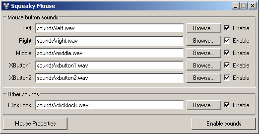

Here's a quickie proof-of-concept:  http://skwire.dcmemb...use/SqueakyMouse.zip
Unzip into its own folder and run SqueakyMouse.exe.  I've included some sample WAV files for testing but feel free to change them to whatever you'd like.  Once you're ready, click the "Enable Sounds" button at the bottom to activate.  Since it's a proof-of-concept, there are no hide-to-tray options, etc.  Please let me know if this works how you had in mind.

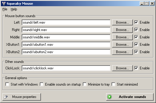

You're very welcome; I'm glad you find it useful.  Here's the website release version with a few extra usability options:
Website | Download
v1.0.1 - 2016-05-03
    + Initial website release.
v1.0.0 - 2016-05-01
    + Initial forum beta.

@luvnbeast: Please test the following release.  You should be able to uncheck the Left button option whilst leaving the ClickLock option enabled, i.e., you shouldn't need that blank WAV file anymore.
Website | Download
v1.0.2 - 2016-05-05
    ! ClickLock sound would not work if the Left button option was disabled.
      They're now independent of each other.  (Thanks, luvnbeast)
