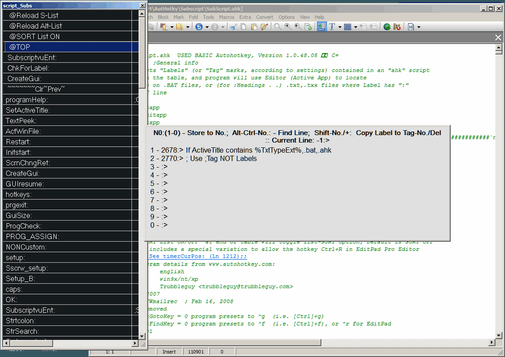

Subscript creates a table of lines within an editable file which contain a predefined "label". The Label consists of predefined characters (Marker) which must appear within the selected lines.
The Table, which can be alphabetically sorted, shows text adjacent to the label and selecting the entry from the  subscript table clears the Label-List and sends commands to the editor to find the selected line in the file. For default extensions listed on key "TxtTypeExt=", when the Label-List appears, pressing a letter (A-Z) will locate the entry starting with the same letter. The "Search" command string is configurable for editors specified in the "Subscript.ini" file, (the default command is [CONTROL]-F), and default for "GOTO-LINE" is [CONTROL]-G). It is not normally necessary to redefine "Clear-Block", but is optionally configurable.
The option exists to redefine label selection to include marker at the START-of_Line, markers at START OR END of line, or lines with predefined markers at BOTH START AND END of line.
Labels can be predefined within Subscript.ini for different specified file .extensions. In addition, provision is made for defining an ALTernate Label marker, to select a different group of lines. The Label-List can optionally also display last 10 selected Labels, and allows rapid selection of top of file (@TOP entry) and END-of-file (~~Bottom~~). The Label-List can be scrolled to show remaining text (comments) on the marked lines.
Also, the program allows creation of a file "TAG" list recording Line-No. and starting text to quickly TAG up to 10 locations within a file, facilitating fast return to originally TAGged locations. These locations do not need associated Label-markers. These TAGGED locations are stored along with the associated filename for up to 20 files and remembered between editing sessions.
Within the program ini file, provision has been made to quickly define up to twenty NEW file extensions, along with START marker, END marker, Alternate marker and marker selection mode, (e.g. START/END of line, or BOTH).

Label-List:
Selecting "SORT List ON/OFF" at top of table will toggle list-SORT option.
Default is SORT OFF (ini file key: SortLst=0), so labels are not ordered alphabetically.
When Label-List is displayed, select label using mouse or cursor keys. "Enter" selects label.
Label-List also includes:
" @Reload S-List" - Create new Label-list (Exclude defined "AltLabel" Subs)
" @Reload Alt-List" - Create new Label-list (using only defined "AltLabel" Subs)
" @SORT List On" - Set display to "Sorted"
" @T-Lmark: + END" - Switch Label marker to START/START or END of line, or BOTH
" @TOP" - Goto top of file
"~Bottom" - Goto end of file

The program also provides a quick "Label-Tag" List to record 10 locations, which are saved and recalled for the last 20 edited filenames in which subscript was run. These locations can be transferred directly from the "Label-List" into a "Tag-No.", or from the edited file.
