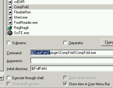

In the settings for the user menu in Sala i use the special token $[xxx]
for to refer to this environment variable i create with my AutoIt script.
i.e. f.ex. $[SalaPath]\MyTools\CSDiff5\CSDiff.exe

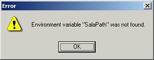

- If Salamander is not startet from this script he tells about missing "SalaPath" for each plugin

# modify the path to your tools
* go to "Options||Configuration...||User menu"
* modify your paths
e.g. from "C:\Program Files\Servant Salamander 2.5 beta 11\Plugins\Tools\MyApp\app.exe"
to "$[SalaPath]\Plugins\Tools\MyApp\app.exe"
"C:\Program Files\Servant Salamander 2.5 beta 11" is in this case the current working dir
which will be covered later by $[SalaPath].
You will see sooner or later that this $[SalaPath] is not found right now.
Remember, this env var is only valid later, if you have execute the script (respectively the compiled exe)
