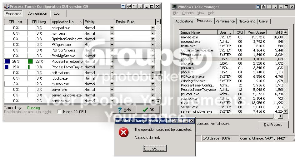

I've taken screen shots of TaskManager and ProcessTamer in the same window. I've also got a second image showing the error message i get when trying to reduce the priority manually.
http://i4.photobucket.com/albums/y141/bigbumben/php.jpg

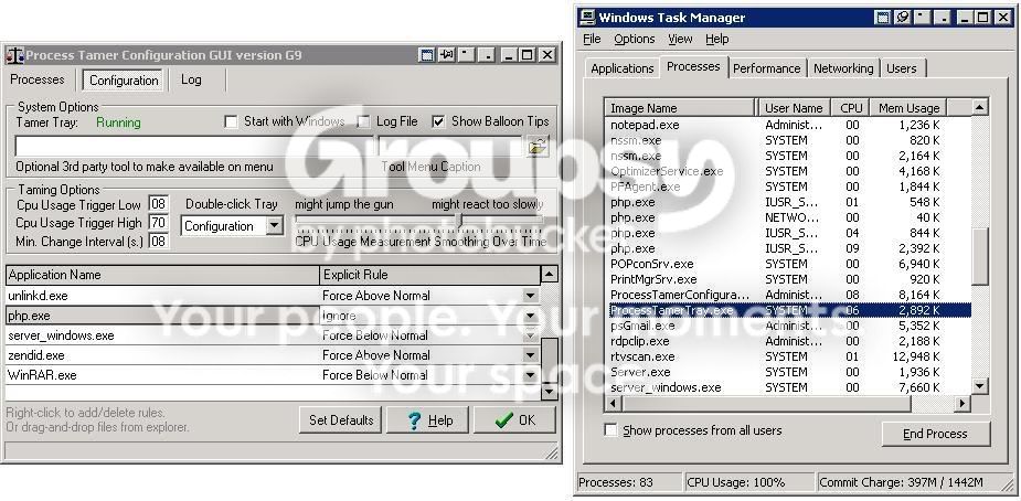

perl.exe
http://i4.photobucket.com/albums/y141/bigbumben/php2.jpg
perl.exe
It's not actually using 40% at the time, in fact the second image shows four different processes using a fairly low cpu, but either way, ProcessTamer doesn't seem to access it.
Thanks,
Ben

what i'm more concerned about at the moment is the high cpu usage of ProcessTamerTray.exe in your screenshots(!).
te ProcessTamerConfigurator.exe is the gui configuration utility that only runs when you configuring it, and its not very efficient, so it can show some pretty high cpu when your using it and that doesn't matter.
but ProcessTamerTray.exe should *never* show such high cpu usage.  On my machine its pegged at 0% cpu except maybe for the brief instant when it tames something and reports it, in which case it might hit 1% briefly.
im thinking it might be trying to change the priority of php.exe or perl.exe and is constantly failing and retrying..

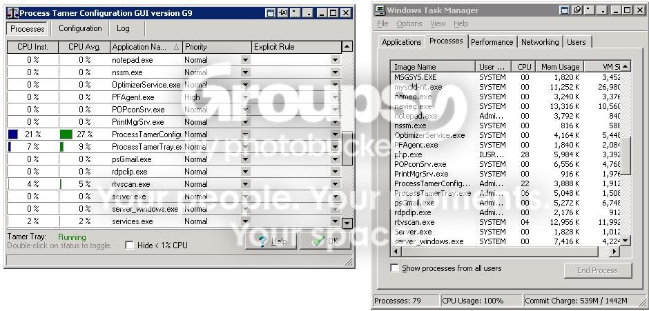

Here you go - you can see php.exe set to ignore, and CPU usage by PT up to 6%
http://i4.photobucket.com/albums/y141/bigbumben/php3.jpg

  • Posts: 40,901
Re: perl.exe
« Reply #20 on: April 16, 2005, 09:29 PM »
thanks ben, ok im going to look into this tonight.. hopefully i'll be able to figure out what is going on.
there is one case i can think of where cpu use of PT could rise above normal, and that is if a ton of processes are being created and destroyed in some short period of time.  i wonder if its possible that this could be happening.. if you look in processes list do you see new processes being born and dying over and over again in rapid succession?
im guessing that that's not it, and that it instead is a bug relating to processes that PT does is not handling right.
i think you said that some instances of php show up in normal windows task manager but not in Process Tamer process list, is that right? i'm guessing that could be a clue.
